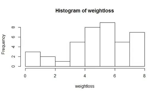

I try to see other way that gave me other element like QQPlot:
> qqnorm(weightloss)
> qqline(weightloss)
As you can see the first points are rightmost and at the end we have one point rightmost too, so maybe I can conclude not normality of the data(see How to interpret a QQ plot). In order to see other points I create a histogram enter image description here
So with this almost I can say that the sample hasn't a normal distribution or I can accept normality with uncertainty. I am not sure about this.
