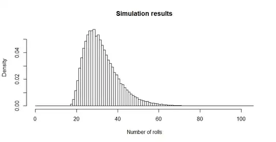

That seemed awfully small to me, so I ran a simulation (using R). After over three million rolls of the dice, this game had been played to its completion over 100,000 times, with an average length of $32.669$. The standard error of that estimate is $0.027$: the difference between this average and the theoretical value is insignificant, confirming the accuracy of the theoretical value.
The distribution of lengths may be of interest. (Obviously it must begin at $18$, the minimum number of rolls needed to collect all six sides three times each.)
Figure
# Specify the problem
d <- 6   # Number of faces
k <- 3   # Number of times to see each
N <- 3.26772e6 # Number of rolls
# Simulate many rolls
set.seed(17)
x <- sample(1:d, N, replace=TRUE)
# Use these rolls to play the game repeatedly.
totals <- sapply(1:d, function(i) cumsum(x==i))
n <- 0
base <- rep(0, d)
i.last <- 0
n.list <- list()
for (i in 1:N) {
  if (min(totals[i, ] - base) >= k) {
    base <- totals[i, ]
    n <- n+1
    n.list[[n]] <- i - i.last
    i.last <- i
# Summarize the results
sim <- unlist(n.list)
mean(sim)
sd(sim) / sqrt(length(sim))
length(sim)
hist(sim, main="Simulation results", xlab="Number of rolls", freq=FALSE, breaks=0:max(sim))
