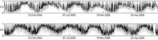

Plot of the two time-series
The shaded regions are 95% CIs.

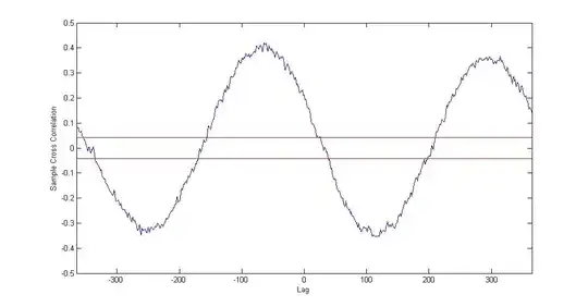

Sample crosscorrelation between the two time-series: Sample crosscorrelation between the two time-series

  • A plot would be interesting and, potentially, helpful. How close to sinusoidal are the two series? – cardinal Jan 13 '12 at 00:20
  • Hi Cardinal. I have a plot, but need 10 reputation points to upload it, unfortunately! I'll do so as soon as that happens. The time-series are related to temperature and vegetation growth, so follow pretty consistent seasonal behaviour, although it is noisy. Without having seen the plots, do you have any thoughts on how to approach this problem? – Paul Keating Jan 13 '12 at 01:21
  • Yes. I have a couple ideas, but I'd like to see a plot first to have a better idea of what you're dealing with. if you upload your plot to imgur and edit the post to provide the link, then I can edit it yet again to put the image inline. The rep will come soon enough. Welcome to the site. – cardinal Jan 13 '12 at 01:26

    As a very first quick-and-dirty check, have you tried plotting the sample crosscorrelation between the two series and finding the peak? There are some curious discontinuities, e.g., in the first series sometime around Feb 2005 or so. – cardinal Jan 13 '12 at 02:00
  • @jbowman: I'm sure it was my fault. Manually editing from an iPad can be a little cumbersome; I got the link wrong the first two times I tried. Hopefully you can see it now. – cardinal Jan 13 '12 at 02:01
  • @cardinal, I've plotted the sample crosscorrelation and will post it in the main section above. There appears to be a distinct peak with a ~2 month lag. This agrees with my initial visual estimate and intuition about the data. You mention that it is a quick-and-dirty check -- what are the limitations with this method, and would you recommend anything else? – Paul Keating Jan 13 '12 at 03:26
