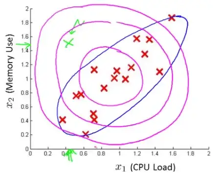

The problem of using only z-score to determine outliers is that if works pretty okay if your variables are independent but they show bad results when they have high correlation between each other.
For example, in the plot below the blue circle is what you expect your normal data to be in.
Blue line is your classification of normal data
You have a new data plotted in green which you expect to be classified as an $outlier$. But according to a z-score analysis (plotted in pink) your new data is classified as $normal$.
To avoid this problem of interpretation you can use Anomaly Detection Systems for giving better predictions or - if you have a lot of data on your outliers - you can use Logistic Regression so it can adapt to what you are looking for.
  • I've tried out anomaly detection as well , but the problem is how to model the features like high profit, low cost .. I've tried to overcome it using zscore using negative sign for low cost any input for the same in anomaly detection? – tourist May 02 '16 at 05:34
  • If I am understainding your problem right, you don't need to model your features. Let your anomaly detection system identify all your outliers and if you wish to select only those datas with high profit and low cost you can filter them using (Xprofit > MUprofit)*(Xcost < MUprofit), where X is your data and MU is the mean. You will end up with a vector with 0s and 1s, where the ones are the outliers that satisfies all your conditions. – Mauricio Ramalho Custodio May 03 '16 at 20:40
  • For your example here mahalanobis distance would work – kjetil b halvorsen Apr 25 '18 at 00:42
