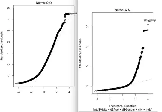

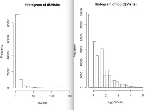

Trying to calculate visit counts from demographics and service. The data is very skewed.
Histograms:
histograms
qq plots (left is log):
qq plots - right is log
m <- lm(d$Visits~d$Age+d$Gender+city+service)
m <- lm(log(d$Visits)~d$Age+d$Gender+city+service)
city and service are factor variables.
I get a low p value *** for all the variables, but I also get a low r-squared of .05. What should I do? Would another model work, like exponential or something?

  • Since what I originally thought was a high frequency of zeroes was actually a high frequency of twos, could you tell us a bit more about the data generating process? What kind of service were people going in for, and what's the "ultimate goal" of the analysis? Are you trying to predict the number (count) of visits, given a set of characteristics (i.e. as a measure of quality of service)? Do you absolutely need to keep the outcome as counts for the purpose of answering your research question, or could you collapse the outcome variable into fewer, but larger categories? – Marquis de Carabas Apr 13 '16 at 22:25

  • a majority is 2~ visits. All of the records are more than 1 visit – pxxd Apr 13 '16 at 05:45
  • I am getting similar qq plots for both glm of poisson and gamma, is that okay? – pxxd Apr 13 '16 at 07:26
