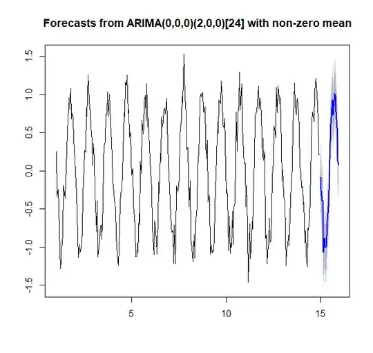

We can then fit a seasonal AR model to the data and get a pretty good forecast for the series. Since we know that the pattern is pretty stable over time, I will use two seasonal lags rather than just one because this will allow the model to smooth out any noise in the data better.
> (dsmodel <- arima(dailyseas, seasonal = c(2L, 0L, 0L)))
Call:
arima(x = dailyseas, seasonal = c(2L, 0L, 0L))
Coefficients:
        sar1    sar2  intercept
      0.4254  0.5396     0.0094
s.e.  0.0455  0.0465     0.1368
sigma^2 estimated as 0.05491:  log likelihood = -20.56,  aic = 49.13
daily seasonal forecast
This is just about perfect, the intercept is near zero, which it should be, and the sum of the coefficients on the seasonal lags is close to 1, meaning the forecast is about an average of them (eg. we predict the value tomorrow at noon is about the average of today and yesterday at noon). It is important to note we let the ARIMA model know how often the pattern repeated itself by making a ts object and setting the frequency = 24. Alternatively, we could have used a vector for the series and set seasonal = list(order = c(1L, 0L, 0L), period = 24).

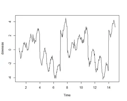

This works well when we have a simple repeating pattern, but what if we have a day of week effect.
Daily Seasonality with a Day of Week effect
A day of week effect is an consistant impact on the underlying series we see based on the day of the week. We can add a day of week effect to our data using:
# Create an adjustment for day of week: we will leave Monday as 0
# so later it is easy to see the change in other days relative to
# Monday.
(doweffect <- c(0 , sample(c(-3, -2, -1, 1, 2, 3))))
# add our day of week effect to the original series
dowseas <- dailyseas + rep(doweffect, 2, each = 24)
plot(dowseas)
seasonal with day of week effect

Hmm, that doesn't look great, our intercept is near zero and our seasonal coefficients are nearly canceling each other out. Lets look at our external regressor model:
# Creates a model where the day of week effect is accounted for using
# an external regressor
> (dowxreg <- arima(dowseas, seasonal = c(2L, 0L, 0L), xreg = dowreg))
Call:
arima(x = dowseas, seasonal = c(2L, 0L, 0L), xreg = dowreg)
Coefficients:
        sar1    sar2  intercept    Tues    Weds    Thurs      Fri      Sat     Sun
      0.4301  0.5351    -0.0080  1.0376  2.0036  -0.9759  -1.9841  -3.0051  3.0363
s.e.  0.0459  0.0468     0.1389  0.0394  0.0360   0.0424   0.0427   0.0413  0.0438
sigma^2 estimated as 0.05457:  log likelihood = -19.51,  aic = 59.01
This is much better, the two seasonal lags (sar1 and sar2) are basically taking an average again like they did in our other model, and the external regressors are adjusting the days by the correct amount (1 for Tues, 2 for Weds, -1 for Thurs, -2 for Fri, -3 for Sat and 3 for Sun). How about our weekly seasonal model:
