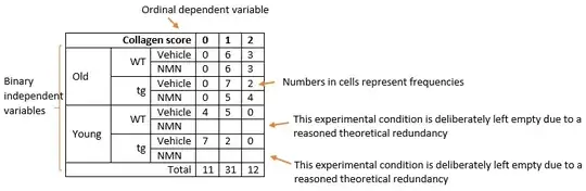

I've been having struggling with the analysis of ordinal categorical data that I have (against 3 binary categorical explanatory variables). The problem is that for one of my data sets,running ordinal logistic regression in SPSS gives an unusual result, which raises questions about the validity of this statistical testing approach to my data:
SPSS Parameter Estimates for Ordinal Logistic Regression
Full SPSS syntax and output can be accessed here
The question arises: why is no statistical result given for the non-redundant level of the age variable, StErr = 0, confidence interval does not exist, logit Estimate so high…? Exponentiation of logit gives some ridiculously high odds ratio… It’s like a perfect result with 100% certainty? Is this statistical test and outcome valid? Can someone explain what is happening in layman's terms? Should I be using a different statistical test than ordinal logistic regression? And please suggest how I should analyse and report it for a scientific publication.
The raw data can be viewed for further insight:
I have also made available the SPSS data file in case you wanted to run the test for yourself:
Access here: SPSS .sav file
I have also attached a visualisation of the data in the form of stacked columns, to help you to quickly familiarise yourself with the character of my data.

  • can you explain what your variables mean and what you're trying to model here? Collagen level as a function of age, treatment, and genotype? What do the subscript 2 for these variables mean? Do they refer to age? You also have some very small cell sizes and if I understand right, empty cells (e.g. cells with 0 frequencies). – Marquis de Carabas Apr 06 '16 at 08:50
  • Correct - collagen level as a function of age, treatment, and genotype. On that particular occasion that I generated that particular output, the subscript "2" for the explanatory variables is of no consequence - I just had to recode the original variables because I want to force SPSS to use the reference group that I wanted. The new resulting recoded variable is labelled "2". In the .sav data file I provided, there is no such "2" distinction - I just recoded into the original variable. Correct - small numbers, zero occurrences, and some purposely empty cells by design. – ptrcao Apr 06 '16 at 09:06

My feeling is that there is insufficient information here in the data-set to fit the model with any confidence. If we had a single observation for age == old & coll == 0 then both functions would fit the model (and give identical results) so the problem here is the zeroes for both (age == old & coll == 0) & (age == young & coll == 2).
