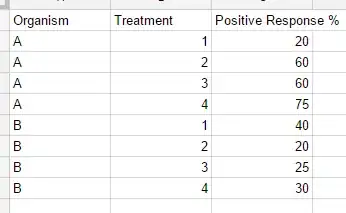

I would like some help choosing the most appropriate stats test to use for my data. I have two different types of organism, four different treatments and then the dependent variable is yes/no did they carry out a behavior.
For example:
data table
EDIT
In a comment OP added: I have the raw data total number yes and total number no for each organism and treatment, which is what I used to calculate the percentage of positive responses.
    The example data contains some "positive response" which is a percentage, so it does not exactly match your description (that there would be a yes/no dependent variable - can you clarify this detail? What are you trying to find out (what scientific question are you interested in)? – Juho Kokkala Apr 03 '16 at 10:19
    It looks like each row represents multiple units. Do you have the original data? Also, note that (per your title) data cannot be parametric or non-parametric; models are parametric or not. It is not yet clear whether you want a parametric model or not. – Peter Flom Apr 03 '16 at 11:56
  • Hi, I have the raw data total number yes and total number no for each organism and treatment, which is what I used to calculate the percentage of positive responses. – statshelp Apr 03 '16 at 12:59
  • I need to see if there are any significant differences between organisms A and B for the same treatments. – statshelp Apr 03 '16 at 13:00
  • I also need to look for significant differences between the treatments for the same organisms. The treatments are an ordinal variable. – statshelp Apr 03 '16 at 13:34
    Welcome to Cross Validated! Data are neither parametric nor nonparametric; those are adjectives that apply to models or techniques. If you mean "not normally distributed" that's not at all the same thing as "nonparametric" and similarly "parametric" is not at all the same thing as "normally distributed" -- one can fit parametric non-normal models and correspondingly, one can happily use nonparametric procedures on data drawn from normal distributions. Please edit your post to more clearly express the actual situation. – Glen_b Apr 03 '16 at 13:56
With the extra information you added in comments, It is clear you have data in binomial form, so I would start with logistic regression. Doing this in R a simple command to start could look like:
df <- data.frame(as.factor(Organism), as.factor(Treatment), Pos, Neg)
mod <- glm(cbind(Pos,Neg) ~ Organism+Treatment, family=binomial, data=df)
Some examples for further analysis on this site may be: Diagnostics for logistic regression?, Intuition behind logistic regression, Analyzing logistic regression coefficients, What is the significance of logistic regression coefficients?
