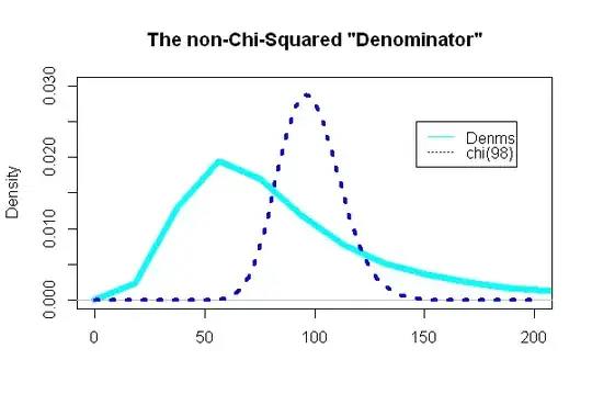

The most interesting part was looking at the "denominator" of the t test, the part that was supposed to follow a chi-squared distribution:
$$(n-1)s^2/\sigma^2=98\,\frac{(49 \, (\text{SD}_A^2 + \text{SD}_A^2))/98} {(e^{\sigma^2}-1) \, e^{2\mu+\sigma^2}}$$.
Here we are using the common standard deviation, as in this Wikipedia entry:
$$S_{X_1X_2}=\sqrt{\frac{(n_1 -1)\,S_{X_1}^2 + (n_2 -1)\,S_{X_2}^2}{n_1+n_2-2}}$$
And, surprisingly (or not) the plot was extremely unlike the superimposed chi-squared pdf:
