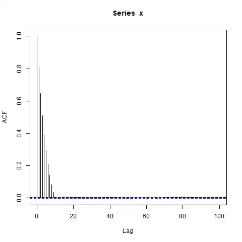

Executive summary: It seems that you are mistaking noise for true autocorrelation due to a small sample size.
You can simply confirm this by increasing the k parameter in your code. See these examples below (I have used your same set.seed(987) throughout to maintain replicability):
k=1000 (your original code)
1000 simulations
k=2000
2000 simulations
k=5000
5000 simulations
k=10000
10000 simulations
k=50000
50000 simulations
This sequence of images tells us two things:
  • The autocorrelation after the first 10 observations greatly diminishes as the number of iterations increases. Indeed, with a sufficiently large number of iterations the $\hat\rho(l)$ for any $l>10$ will converge to zero. This is the basis for my statement at the beginning - that the autocorrelation that you observed was simply noise.
  • Notwithstanding the aforementioned observation that $\hat\rho(l)$ converges to zero for any $l>10$ as the number of simulation increases, $\hat\rho(l)$ for any $l \le 10$ actually remains constant at $\hat\rho(l)=\rho(l)=0.9^l$, just as the construction of your model would suggest.
Note that I refer to the observed autocorrelation as $\hat\rho(l)$ and to the true autocorrelation as $\rho(l)$.

    The sample ACF is itself autocorrelated, so it isn't white noise. Other than that, I agree, it's just a noise / sample size issue. – Adrian Nov 16 '17 at 22:44
  • @Adrian You are correct. I amended my answer accordingly. – Candamir Nov 16 '17 at 22:48
  • It also becomes less and less likely to "stray" outside a confidence band -- are you sure that's true? – Adrian Nov 17 '17 at 02:32
    Thanks for poking holes into the weak parts of my answer. I have to admit that statement was only based on visual inspection. I did some further research and found out that the confidence band is calculated as qnorm((1 + ci)/2)/sqrt(x$n.used), i.e. $cdf(1-\alpha/2)/\sqrt{n}$ (see here). However, I have not been able to nail down the convergence rate for the observed autocorrelation. I asked this new question to settle the matter but have removed this point from this answer in the meantime. – Candamir Nov 18 '17 at 15:56
    @Adrian My question regarding the convergence rate of the observed autocorrelation has been answered. It turns out that its convergence rate is the same as the one of the confidence band: $1/{\sqrt{n}}$. My original claim that the observed autocorrelation becomes less and less likely to "stray" outside the confidence band is thus incorrect. That being said, the fact that $\hat\rho(l)$ converges to zero for any $l>10$ as the number of simulations increases still resolves your question, even if I was wrong about the relative rate of convergence. – Candamir Nov 20 '17 at 20:45
