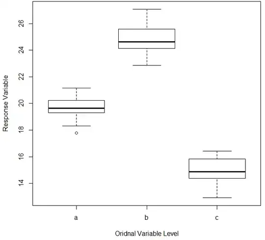

For example, given an independent variable with ordinal levels (a, b, c) and a response variable, consider two possible variable responses:
[A]
[B]
In [A], the ordinal predictors would very poorly model the binomial response, whereas in B the linear response would be just fine.
In [A], you would definitely want to use the ordinal predictor as a categorical variable instead of as a numeric representation, whereas in [B] the numeric representation of ordinal levels would be just fine.
