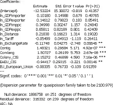

We performed calculation of the gravity model in R and Stata software.
For calculations we used the standard package glmm in R (with parameter family = quasipoisson), and ppml in Stata.
Call the calculation procedure in R:
summary(glmm<-glm(formula=exports ~ ln_GDPimporter + ln_GDPexporter +
    ln_GDPimppc + ln_GDPexppc + ln_Distance + ln_Tariff + ln_ExchangeRate +
    Contig + Comlang + Colony_CIS + EAEU_CIS + EU_European_Union,
    family=quasipoisson(link="log"),data=data_pua))
The results in R were:
The results of the calculations in R

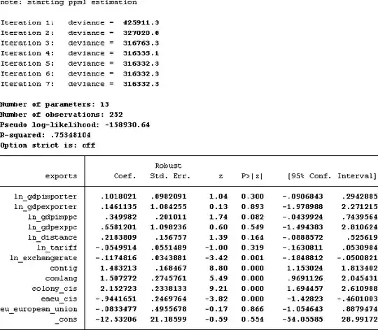

On the same data, we performed calculations in Stata, using ppml procedure:
ppml exports ln_gdpimporter ln_gdpexporter ln_gdpimppc ln_gdpexppc ln_distance ln_tariff ln_exchangerate contig comlang colony_cis eaeu_cis eu_european_union
The results of the calculations in Stata were following:
As you can see, model coefficients (second column in the results table) are the same at least until the 4th mark decimal place.
However, other results (from the third column in the table of results) are not the same.
  • Could you explain differences in the results?
  • In particular, why are coefficients the same (the first result table columns), but standard errors are not?

I note that the Stata coefficient table mentioned "Robust Std. Err.", while glmm is probably not using robust errors. That would account for SE differences.
Also, ppml seems to actually drop "non-significant" regressors, and R's quasipoisson family allows for over dispersion in a way that's different from, say, negative binomial regression, which is perhaps different from ppml.

To expand on Wayne's excellent answer, ppml uses a robust (to heteroskedasticity) variance-covariance matrix and also a finite sample adjustment to that matrix to reduce bias.
These are very similar to what sandwich() from the package of the same name computes in R. The only difference is how the finite-sample adjustment is done. In the sandwich(...) function, no finite-sample adjustment is done at all by default, i.e., the sandwich is divided by 1/n where n is the number of observations. Alternatively, sandwich(..., adjust = TRUE) can be used which divides by 1/(n - k) where k is the number of regressors. Stata, however, divides by 1/(n - 1).
Here's how you can get R to match Stata by using a custom sandwich variance with an adjustment factor of 1/(n-1):

. ppml y x w
note: checking the existence of the estimates
Number of regressors excluded to ensure that the estimates exist: 0
Number of observations excluded: 0
note: starting ppml estimation
note: y has noninteger values
Iteration 1:   deviance =  139.7855
Iteration 2:   deviance =  137.7284
Iteration 3:   deviance =  137.7222
Iteration 4:   deviance =  137.7222
Number of parameters: 3
Number of observations: 100
Pseudo log-likelihood: -173.89764
R-squared: .01628639
Option strict is: off
             |               Robust
           y |      Coef.   Std. Err.      z    P>|z|     [95% Conf. Interval]
           x |   .1256565   .1015913     1.24   0.216    -.0734588    .3247718
           w |   .0134101   .7107518     0.02   0.985    -1.379638    1.406458
       _cons |   .5169689   .0980624     5.27   0.000     .3247702    .7091676
