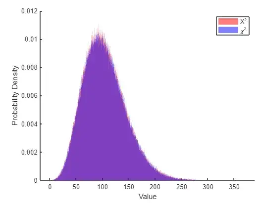

A noncentral $\chi^2$ distribution, applies only to a normal variable with unit variance. In such case, the square of random variable $X_1\sim N(x|\mu, 1)$ is noncentral $\chi^2$ distributed with degrees of freedom $k=1$ and noncentrality parameter $\lambda=\mu^2$: $$ X_1^2=Z\sim \chi^2(z_1|k, \lambda).$$
However, one can establish a relationship between a normally distributed variable $X_2 \sim N(x_2|\mu,\sigma)$ and noncentral $Z_2 \sim \chi^2(z_2|1,\tfrac{\mu^2}{\sigma^2})$ distributed variable as such: $$X_2^2=Z\sigma^2$$
Proof by example:
mu = 10;     % Mean of the normal
distribution sigma = 2; % Standard deviation of the normal distribution num_samples = 1000000; % Number of samples
% Generate normal random variables with specified mean and standard deviation X = normrnd(mu, sigma, num_samples, 1);
% Compute the squares X_squared = (X).^2;
% Compute non-centrality parameter lambda = (mu/sigma)^2;
% Generate samples from non-central chi-squared distribution Y = ncx2rnd(1, lambda, num_samples, 1);
% Plot histograms figure; hold on; histogram(X_squared, 'Normalization', 'pdf', 'BinWidth', 0.1, 'FaceColor', 'r', 'FaceAlpha', 0.5, 'EdgeColor','none'); histogram(Y*sigma^2, 'Normalization', 'pdf', 'BinWidth', 0.1, 'FaceColor', 'b', 'FaceAlpha', 0.5, 'EdgeColor','none'); xlabel('Value'); ylabel('Probability Density');
% Add legend legend('X^2', '\chi^2');
slune
Here is Matlab code showing that the answer by Brent Kerby is not true.
mu = 10;     % Mean of the normal distribution
% Compute the squares X_squared = X.^2;
% Plot histograms figure; hold on; histogram(X_squared, 'Normalization', 'pdf', 'BinWidth', 0.1, 'FaceColor', 'r', 'FaceAlpha', 0.5, 'EdgeColor','none'); histogram(Y, 'Normalization', 'pdf', 'BinWidth', 0.1, 'FaceColor', 'b', 'FaceAlpha', 0.5, 'EdgeColor','none'); xlabel('Value'); ylabel('Probability Density');
slune
