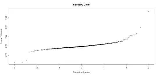

These tests suggest that my residuals are not normally distributed. Should I still consider the model based on R-squared and F-Value or make some corrections? Please suggest
Here is the residual plot: enter image description here

  • What does the plot of the residuals look like? Also, can you explain the data setup? What is the response here? My most natural instinct is a transformation of the response. – Greenparker Mar 09 '16 at 09:17
  • As @Greenparker said, how does residual plots look like? See also: https://stats.stackexchange.com/questions/2492/is-normality-testing-essentially-useless – Tim Mar 09 '16 at 09:20
  • @AnuragH, a plot of the residuals means predicted values on the x axes and the residuals on the y axes. If you used lm() in R, then you can get the diagnostic plot when you do plot(lm.object). Also, it looks like you might have at least one outlier that might be affecting your results. The QQ plot looks a little heavy tailed, but nothing that suggests anything too crazy. – Greenparker Mar 09 '16 at 10:13
  • @Greenparker I am updating the post with the diagnostic plots and yes I found about 13 outliers using the Box Plot, even after removing them I do not see great improvement. I am attaching the plot(lm.object) after removing the outliers, do let me know what can I do next. Thanks – Anurag H Mar 09 '16 at 10:32
  • @AnuragH I edited your question to rollback the previous version of the question and add the new plots. Your last edit changed your question into a totally different problem. – Tim Mar 09 '16 at 11:12
  • @Tim Thanks for doing that, I did not have enough credits to add more links hence had to remove :) – Anurag H Mar 09 '16 at 11:18
It is always good to look at plotted data. In case of regression, it is good to look at residuals plots. In your case residuals seem to come from distribution with longer tails than normal. Distribution of your data is closer to $t$-distribution and actually I was able to produce a similar data example for $t_2$ distribution.

But this is of smaller importance. What the residual plot really shows you is that your distribution has longer tails, i.e. it has some outliers. Now you should ask yourself what are the outlying values? Identify and check the values. Why are they outlying? Is it the measured phenomenon having long tail distribution that produced them, or maybe there was some issues with measurement (are they erroneous)? The outlying values can influence your final estimate, so you have to make a number of decisions on what do do with the outlying values. Check also How should outliers be dealt with in linear regression analysis? and Interpreting the residuals vs. fitted values plot for verifying the assumptions of a linear model threads.

  • @AnuragH I see that you edited your question - it would be better if you rather left the previous plots and added the new ones since your last edit changes your question to totally different one. As about new plots - they seem to show a totally different pattern: with some small "cluster" of outlying values and overall linear trend in residuals. This needs further investigation (search this site for residuals regression for multiple similar cases and examples). – Tim Mar 09 '16 at 11:09
