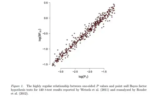

    So while Wagenmakers et al. keep insisting that $p$-values are deeply flawed and Bayes factors are the way to go, one cannot but wonder... (To be fair, the point of Wetzels et al. 2011 is that for $p$-values close to $0.05$ Bayes factors only indicate very weak evidence against the null; but note that this can be easily dealt with in a frequentist paradigm simply by using a more stringent $\alpha$, something that a lot of people are advocating anyway.)
    One of the more popular papers by Wagenmakers et al. in the defense of Bayes factors is 2011, Why psychologists must change the way they analyze their data: The case of psi where he argues that infamous Bem's paper on predicting the future would not have reached their faulty conclusions if only they had used Bayes factors instead of $p$-values. See this thoughtful blog post by Ulrich Schimmack for a detailed (and IMHO convincing) counter-argument: Why Psychologists Should Not Change The Way They Analyze Their Data: The Devil is in the Default Prior.

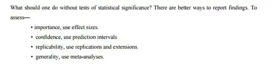

A Brilliant forecaster Scott Armstrong from Wharton published an article a almost 10 years ago titled Significance Tests Harm Progress in Forecasting in the international journal of forecasting a journal that he co-founded. Even though this is in forecasting, it could be generalized to any data analysis or decision making. In the article he states that:
"tests of statistical significance harms scientific progress. Efforts to find exceptions to this conclusion have, to date, turned up none."
This is an excellent read for any one interested in antithetical view of significance testing and P values.
The reason why I like this article is because Armstrong provides alternatives to significance testing which is succinct and could be easily understood especially for a non-statistician like me. This is much better in my opinion than the ASA article cited in the question:enter image description here
All of which I continue to embrace and ever since stopped using significance testing or looking at P values except when I do randomized experimental studies or quasi experiments. I must add randomized experiments are very rare in practice except in pharmaceutical industry/life sciences and in some fields in Engineering.
