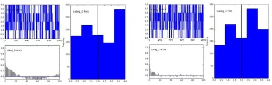

However, with the Categorical part, the traces look like the following (showing only one plot for $\mu$ and $\sigma$ each; others look quite similar). posterior predictive, true histogram with Categorical mu, sigma group0, group1 group2,group3
Can someone point out what I might be doing wrong here? Some of the potential issues I can see are:
  1. The acceptance rate for Categorical is very low (5-7%).
  2. Number of parameters are too high, especially because of the number of $\theta$ parameters are $c*g$ . In fact, the number of parameters are always going to be several times larger than the number of observations, no matter how many observations I have.
  3. MCMC has not yet converged. Some of the categorical plots seem to hint at this, but I am not sure. With 50,000 iterations, sampling took about 700sec.
