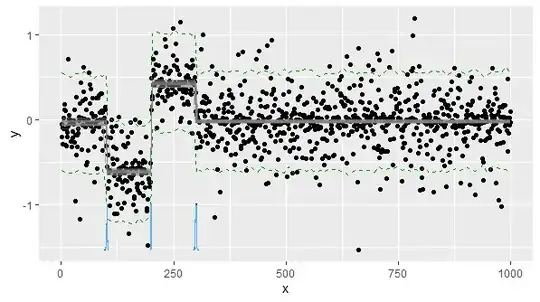

Briefly, the package mcp does Bayesian change point regression. As of v0.2, it takes Gaussian, Binomial, Bernoulli, and Poisson. Modeling your data as four intercept-only segments:

df = data.frame(x = seq_along(coverages), y = coverages)
fit = mcp(model, df, par_x = "x")
Let's plot it with a prediction interval, just for fun (green dashed lines). The blue curves are posterior densities for the change point locations. The gray lines are random draws from the posterior.
plot(fit, q_predict = T)
You can use plot_pars() to plot individual parameter estimates. Here are the summaries. where cp_* are the change point estimates:
summary(fit))

Read more on the mcp website. Disclaimer: I am the developer of mcp.

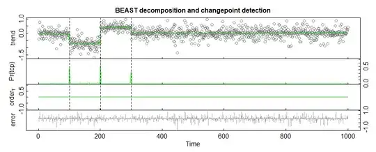

Another package for Bayesian changepoint detection is Rbeast ( https://github.com/zhaokg/Rbeast, written by me), which handles only time-series or sequence-like data and therefore is not as versatile as mcp or bcp. But it is useful for your use scenario. Rbeast is aimed also to decompose time series into periodic and trend components. Since your sequence contains no periodic/seasonal component, season='none' is set in the code below and only the trend component is fitted:

Below is the Rbeast output:
For each segment,Rbeast fits either a linear (1st order polynomial) or constant (0-th order poly) model; the average order of the polynomials needed to adequately fit the trend is estimated over time and depicted as the Order_t curve in the figure: all close to 0, suggesting an overall flat curve over individual segments. For your sample time series, since we know the segments are constant beforehand, we can enforce this strong prior by setting the min and max order of the segments (polynomial) to both 0: torder.minmax=c(0,0) so that only constant lines are fitted.
out = beast(coverages, season='none', torder.minmax=c(0,0) )
plot(out)
