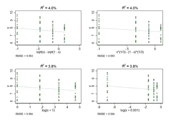

Turning to your fake but seemingly realistic dataset (which I imported into my own favourite software, but analysis is simple in anything decent), it turns out that none of these transformations really helps at all. But graphing the data gives a clear warning that even $\log(x + 0.001)$ is a mighty strong transformation, as can be seen also by plotting it directly.
The two main points I wish to make are that
  1. $\log (x + c)$ often suggested, and often seemingly regarded as innocuous, is a dangerous transformation unless understood and often inappropriate whenever it stretches out the distribution mightily for small $x$ (unless this really is the desired behaviour).
  2. For your example data, no transformation I tried seems to help.
At the same time, other possibilities are far from exhausted. (Notably, I didn't try square root or cube root, and stress that in many other problems those could be obvious and serious candidates.)
The first set of graphs simply shows some candidate transformations for proportions that can attain both $0$ and $1$. (I used natural logarithms, but shapes don't depend on the base chosen).
The second set of graphs shows no transformation helping much for the example data. (For comparison, a plain regression on the original data yields $R^2 = 3.7$%, RMSE $= 0.994$.)
