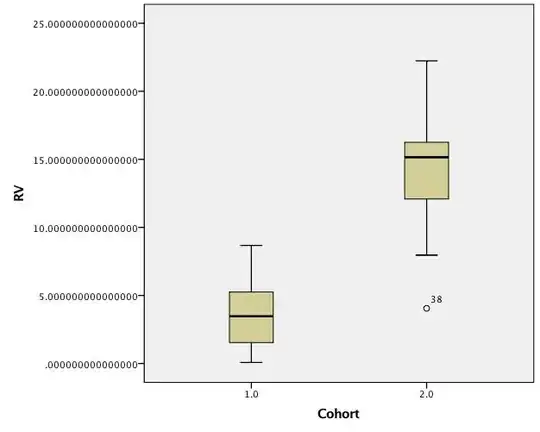

To clarify, the main issue is lack of homogeneity of variance for the Two-Way ANOVA. I had previously written that the transformations did not work to normalize the data -- I was mistaken (my apologies!). The data were very positively skewed (kurtosis was not really an issue), and the square root transformation successfully normalized the distribution. However, I still have heterogeneous variances. I'm wondering if there's anything I can do to correct this, or if it's acceptable to go ahead with the ANOVA, and explicitly mention the heterogeneous variances in the description of my methods?
EDIT 2 (images added):
Boxplots of untransformed data:
EDIT 3 (raw data added):

  • You should ideally show us your data if the dataset is not too large; certainly more precise information about the data is needed, e.g. dot plots, box plots or histograms of all four groups, with min, max, mean, SD, median, IQR. Finding a suitable transformation is not shooting in the dark: in particular, if logarithm is a serious candidate, then square cannot be, and vice versa, as they have completely opposite effects. Note that logarithm (base 10, presumably) and natural logarithm are identical in their effects on no-normality.or unequal variances. – Nick Cox Feb 12 '16 at 10:11
  • In 2) note that the null hypothesis is about the means, not the variances. But indeed it is in the simplest case an assumption (in the usual terminology) that all four variances are the same. (These techniques would be a little easier to understand perhaps if instead of assumptions people talked about ideal conditions.) – Nick Cox Feb 12 '16 at 10:14
  • You didn't follow up on most of my suggestions. At a wild guess, a stronger transformation such as logarithmic might do more to stabilise variances. I would still rather see data or at least graphs to comment. – Nick Cox Feb 12 '16 at 23:36
  • Unfortunately I'm not sure how to post the raw data, so I added box plots. It seems like the square root transformation does a better job of stabilizing variances than the log. (The p-value for Levene's test using square-root transformed data is is .04, whereas for log, it is .000 and untransformed, it is .001). – CH.7 Feb 15 '16 at 00:57

Thanks for posting the data. Posting shows that the box plots concealed, although not intentionally, the sample sizes and important detail too. Whenever I see skewness on a positive response, my first instinct is to reach for logarithms, as they so often work well. Here, however, logarithms drastically over-transform, and plotting everything shows up a small surprise, namely that the two lowest values need care and attention.
The graph here is a quantile-box plot in which the original data points are plotted in order on scales consistent with the box idea (i.e. about half the points are inside the box and about half outside, the "about" being a side-effect of sample sizes like 11).
A more cautious square root transformation seems about right.
