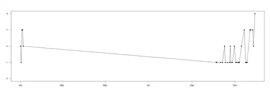

Let's plot this. Always start by plotting the data:
with(dataset,plot(date,sales,type="o",pch=19,xlab="",ylab="",
  ylim=range(c(0,dataset$sales))))
sales

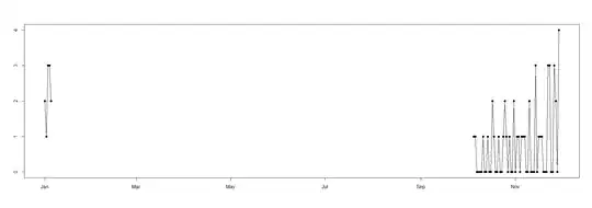

Now, you write in your comment that your data is seasonal. That explains the long string of no data between 2015-01-05 and 2015-10-05. However, you have positive sales on 2015-10-05, 06, 11 and 14. In my experience, this means that product was available on 2015-10-07, 08, 09, 10, 12 and 13, but that there simply was zero demand. As per above, we need to take these zero demands into account in modeling and forecasting, since zero demands will occur again in the future, and if we don't consider them historically, our forecasts will be biased upward. So I'll transform your data by filling in zeros on dates with no sales records between 2015-10-05 and 2015-11-29. (I would do the same between 2015-01-01 and 2015-01-05, but all dates there do have nonzero sales records.)
(Note incidentally, that we have a source of potential confusion here. To a retailer, a "seasonal" product is often one that is only available during certain times of the year. To the time series analyst and forecaster, "seasonal" is a time series that is defined the entire time, but exhibits seasonal peaks and troughs.)
dataset.new <- data.frame(
  date=seq(min(dataset$date),max(dataset$date),by="day"),sales=NA)
dataset.new[as.Date("2015-10-05")<=dataset.new$date,"sales"] <- 0
dataset.new[dataset.new$date %in% dataset$date,"sales"] <- dataset$sales
(Note that the last line relies on both dataset and dataset.new being sorted by date.)
with(dataset.new,plot(date,sales,type="o",pch=19,xlab="",ylab=""))
sales new
Note the zero sales inferred at the end.

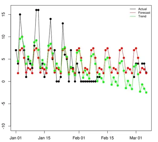

Now we can start modeling. Let's first define a forecast period:
horizon <- 30
dates.forecast <- max(dataset.new$date)+(1:horizon)
We start with a simple day-of-week model, which will simply forecast the average of Monday sales for future Mondays and so forth, as proposed above. The easiest way to do this is to use lm() to create a linear model together with weekdays():
model.dow <- lm(sales~weekdays(date)-1,dataset.new)
summary(model.dow)
forecast.dow <- predict(model.dow,newdata=data.frame(date=dates.forecast))
The summary shows the inner workings of the model. Here is part of its output:
Coefficients:
                        Estimate Std. Error t value Pr(>|t|)
weekdays(date)Friday      0.4444     0.3464   1.283 0.204969
weekdays(date)Monday      1.0000     0.3464   2.887 0.005586 **
weekdays(date)Saturday    1.3333     0.3464   3.849 0.000316 ***
weekdays(date)Sunday      1.5556     0.3464   4.491 3.78e-05 ***
weekdays(date)Thursday    0.6667     0.3464   1.925 0.059566 .
weekdays(date)Tuesday     0.6250     0.3674   1.701 0.094687 .
weekdays(date)Wednesday   0.5000     0.3674   1.361 0.179219
Since I used -1 in my lm() call, no intercept is used, so the coefficients correspond to the weekday averages and the forecasts.
We can also add a trend, simply by adding a +date in the lm() formula, since dates are internally converted to counts of days:
model.dow.trend <- lm(sales~weekdays(date)+date-1,dataset.new)
summary(model.dow.trend)
forecast.dow.trend <- predict(model.dow.trend,newdata=data.frame(date=dates.forecast))
Here is the summary:
Coefficients:
weekdays(date)Friday    61.722324  25.609466   2.410   0.0194 *
weekdays(date)Monday    62.266061  25.604528   2.432   0.0184 *
weekdays(date)Saturday  62.614880  25.610999   2.445   0.0178 *
weekdays(date)Sunday    62.840770  25.612531   2.454   0.0175 *
weekdays(date)Thursday  61.940878  25.607933   2.419   0.0190 *
weekdays(date)Tuesday   62.015965  25.656988   2.417   0.0191 *
weekdays(date)Wednesday 61.894633  25.658521   2.412   0.0193 *
date                    -0.003668   0.001533  -2.393   0.0203 *
The date coefficient tells us that sales decrease by 0.0037 units per day. (Remember that there were quite a few inferred zero sales dates near the end of your time series, but none at the beginning.)
Let's plot:
with(dataset.new,plot(date,sales,type="o",pch=19,xlab="",ylab="",
    xlim=range(c(dataset.new$date,dates.forecast))))
lines(dates.forecast,forecast.dow,type="o",pch=19,col="red")
lines(dates.forecast,forecast.dow.trend,type="o",pch=19,col="green")
forecasts
We can see the day-of-week pattern, as well as the downward trend in the green forecast. If you want longer-range trended forecasts, it is good practice to dampen the trend, for which you'd need to explicitly define a trend column in your data matrices.
