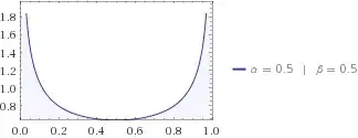

You might try other distributions, maybe your neighbor tells you the cat likes to be near either of the houses, so his beta distribution is with $\alpha=\beta=1/2$. Its $H$ must be lower than that of uniform again, because you get some idea about where to look for a cat. Guess whether your neighbor's information entropy is higher or lower than your kids'? I'd bet on kids any day on these matters.
