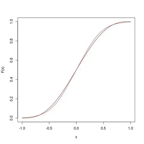

I suggest the inverse cdf method. For the biweight kernel, $$ \begin{align}F(x)&=\int_{-1}^x \frac{15}{16}(1-u^2)^2\text{d}u\\ &= \int_{-1}^x \frac{15}{16}(1-2u^2+u^4)\text{d}u\\ &=\frac{15}{16}\left\{ x+1-2\frac{x^3+1}{3}+\frac{x^5+1}{5}\right\}\\\end{align} $$ which can be inverted numerically, while, for the cosine kernel, $$ \begin{align}F(x)&=\int_{-1}^x \frac{\pi}{4}\cos(\pi u/2)\text{d}u\\ &= \frac{1}{2}\{\sin(\pi x/2)+1\}\end{align}$$ which produces $$F^{-1}(u)=2\arcsin(2u-1)/\pi$$ Note that the biweight cdf looks very similar to the logistic cdf $$G(x)=\dfrac{1}{1+\exp\{-4x^2+3\text{sign}(x)x^2/2\}}$$which helps with the inversion: enter image description here
