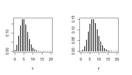

and two marginal distributions
by marginal distribution we mean how would joint distribution "look like" if we looked at it "from the $X$ side", or "from the $Y$ side". Marginal distributions of $X$ and $Y$ are Poisson distributions with parameters $\lambda_X = \lambda_1+\lambda_3$ and $\lambda_Y = \lambda_2+\lambda_3$.
