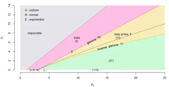

Here's a basic diagram (based on one I did for some notes I wrote last year on the Pearson family):
![enter image description here
Note that I have $\beta_2$ (kurtosis) on the x-axis and $\beta_1$ (squared skewness) on the y-axis. This is because the plots work better in this orientation as you need more space for kurtosis.
The Pearson distribution types are marked with Roman numerals in parentheses. Note that the named distributions (like the "gamma" on the "(III)" line) encompass scaled and shifted versions of those families (including negative scales).
[My diagram doesn't split up the beta (type $\text{I}$) region into "U"-shaped/"J"-shaped/hill-shaped subregions but some diagrams do so]
Here's some examples of adding some distributions which are not Pearson family:
  • case 1 (single distribution before location/scale transform): Logistic distribution
    Wikipedia gives skewness as 0 and Excess kurtosis as 1.2, so $\beta_1=$ 0 and $\beta_2=$ 4.2. So we want to plot a point (marked with say "L") at (4.2,0)
  • case 2 (1-parameter family before location-scale): Lognormal distribution
    Wikipedia gives skewness as $(e^{\sigma^2}\!\!+2) \sqrt{e^{\sigma^2}\!\!-1}$
    and excess kurtosis as $e^{4\sigma^2}\!\! + 2e^{3\sigma^2}\!\! + 3e^{2\sigma^2}\!\! - 6$
    Writing $a$ for $e^{\sigma^2}$, this means that
    $\beta_1=(a+2)^2(a-1)$
    $\beta_2=a^4\!\! + 2a^3\!\! + 3a^2\!\! - 3$
    The direct relationship between these two is not immediately obvious so let's use $a$ to parameterize it. As $a\to 1$, note that this approaches the normal. At $a=1.724$ we reach the right edge of our diagram so we should have $a$ vary between those values. If we choose enough values (10 is probably enough since it isn't strongly curved) we get a smooth looking curve.
    The logistic point is at the bottom to the right of the normal point.
    The lognormal curve is shown with dashed black lines, in the type $\text{VI}$ region (but it's not type VI).

Here the blue point is a particular sample (as it happens, from an ExGaussian). Note that this display has the axes flipped around from my earlier diagram. (It's harder to add additional distribution points and lines to this, but it is still possible if you look at what the code in descdist does, specifically with how it uses the kurtmax variable.)

(It is necessary to stretch the plot area to be roughly the shape I made it above or the slanted text won't be in the right place.)
The code to place the point for the logistic and the curve for the lognormal is then:
 points(4.2,0,pch="L")
 a=c((10:17)/10,1.724)
 lines(a^4 + 2*a^3 + 3*a^2 - 3,(a+2)^2*(a-1),lty=2)
