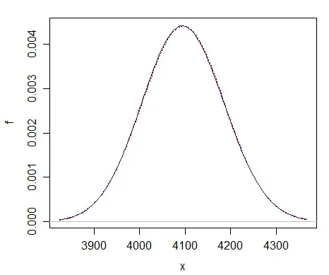

A chi-square with large degrees of freedom $\nu$ is approximately normal with mean $\nu$ and variance $2\nu$.
In this case, ten billion degrees of freedom is plenty; unless you're interested in high accuracy at extreme p-values (very far from 0.05), the normal approximation of the chi-square will be fine.
Here's a comparison at a mere $\nu=2^{12}$ -- you can see that the normal approximation (dotted blue curve) is almost indistinguishable from the chi-square (solid dark red curve).
The approximation is far better at much larger df.

    That's a graph of $x^2$ and not $x$, right? And with such small p-values, what confidence level should I choose? – user19087 Dec 28 '15 at 18:32
  • The drawing is simply the density of a chi-square random variate ($X$), which density is a function of $x$. You're doing a hypothesis test, so you don't have a confidence level. You do have a significance level but you don't choose that after you see a p-value, you choose that before you start. – Glen_b Dec 28 '15 at 23:56
    Yes, that is the graph of the PDF of the $x^2_k$ distribution. Given the name of Pearson's test statistic ($x^2$), I wasn't sure if $x$ references the x-axis (in which case I should take the square root of the statistic first) or the distribution name (in which case the statistic maps directly to the axis). Empirical testing of $\text{p-value} = 1 - CDF$ compared to tables confirms the latter. – user19087 Dec 30 '15 at 02:37
