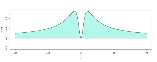

However when dealing with the second moment $$ E\left( X^2 \right) = \int_{-\infty}^{+\infty} x^2 f(x) \mathrm dx,$$ as we have $x^2 f(x) \ge 0$ for all $x$, if the limits $$ \int_0^{+\infty} x^2 f(x) \mathrm dx = \lim_{T\rightarrow+\infty} \int_0^T x^2 f(x) \mathrm dx, $$ $$ \int_{-\infty}^0 x^2 f(x) \mathrm dx = \lim_{T\rightarrow-\infty} \int_T^0 x^2 f(x) \mathrm dx,$$ are not finite, they necessarily go to $+\infty$, hence either $E\left(X^2\right)$ is finite, or it is $+\infty$ if you accept values in $\overline{\mathbb R}$.
Concretely, the area under a curve which is always in the upper half plane is always defined in $\mathbb R \cup \{+\infty\}$. On the following picture (graph of $x^2 f(x)$ with $f$ the density of the $t$ distribution with 2 df), it is infinite.
t^2f(t)

    +1 Great illustrations. They make one think: on a computer there will be limits to the size of numbers that can be represented and usually they will be symmetric. In that case we actually have a truncated distribution. By the same argument, it does have a mean and the mean is zero! I am moved to ask: to what extent should one be concerned about a behavior that truly happens at infinity when working on practical problems that necessarily use finite numbers? I'm not fishing for an answer--I can think of plenty of rejoinders--but just want to put that idea out there for general consideration. – whuber Jan 19 '12 at 22:41
    @whuber Thanks for thoughtful comments. It is indeed true that in practice, a centered distribution with huge variance for which we have only small finite samples, or a distribution without a first moment... I don’t think it makes no difference. Actual and potential infinites... I am sure you remember this question :test for finite variance where you and Henry gave nice answers. – Elvis Jan 19 '12 at 22:51
  • It is unsettling to see a graph with axis labeled $f(x)$ and the curve dipping below the horizontal axis. Could you please change the label to $xf(x)$ and say more clearly that the graph is that of the integrand in the expression for $E[X]$ and not "on the following picture ($t$-distribution with one df)" because the picture is neither of the $T$ distribution nor of the $t$ density with one df? Ditto for the second graph which shows $x^2f(x)$. Thanks. – Dilip Sarwate Jan 19 '12 at 23:08
  • @DilipSarwate Thanks for your vigilance, I’ll correct that. – Elvis Jan 20 '12 at 22:05
