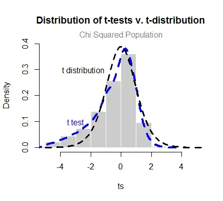

As a way of example of what I'm considering, a possible (probably flawed) approach to the first part of the question would be to extract samples from a $\chi^2_1$. Thanks to the help from the commenters at this point I got this plot with code here:
This is surprising because I expected to see more of a discrepancy between the t-statistic and the t-test based on the underlying population (chi-squared). Although perhaps it should not be surprising at all if we compare it with samples from the almighty Normal, which fit just so:
So is the offset in the first plot "clearly" off? Is it fair to compare it to the normal? Just side questions, the actual points I am asking are clearly stated above.
EDIT: If there is no official answer, I want to at least reflect here the valuable tip offered by @Scortchi in the comments to illustrate how real the offset is:
The 0.5% quantile for the t-test statatics generated in the simulation quantile(ts, 0.005) = -9.682655, whereas qt(0.005, df=9) = -3.249836.

  • Make a function to simulate the $n$ chi-squared r.v.s & calculate the t-statistic to test the null hypothesis that the true mean is one (which it is for a chi-squared r.v. with 1 df): t.stat.sim <- function(n){x <- rchisq(n, df=1); return(sqrt(n)*(mean(x) - 1) / sd(x))}. Then collect the t-statistics for 1000 samples of ten: ts <- replicate(1000, t.stat.sim(10)). [Don't know if you saw that before deleting the answer.] – Scortchi - Reinstate Monica Nov 30 '15 at 17:39
  • @Scortchi I kind of blended your suggestion with my original code and amoeba's comment, but the result seems to actually prove the opposite of what I intended. Here's "my" new simulation. – Antoni Parellada Nov 30 '15 at 18:35

  • Doesn't seem all that close. Compare some quantiles in the tails of the simulated t statistic quantile(ts, c(0.005, 0.025, 0.05) with those of Student's t distribution qt(0.025, df=9). It's these you'd use in forming tests & confidence intervals. Often it's useful to plot cumulative distribution functions & zoom in on the tails. – Scortchi - Reinstate Monica Dec 01 '15 at 10:22
  • @Scortchi Thank you very much for your help. On the first expression, ts is as defined in your prior comment, or in the code that I share on a hyperlink, and that I used to generated the plots? And, on the second expression, I can't find sample_ts defined on either your code or mine. – Antoni Parellada Dec 01 '15 at 13:52
  • Sorry, corrected. ts as in your code (should be the same anyway) but without the truncation ts <- ts[ts<10 & ts>-5] (which I don't understand). – Scortchi - Reinstate Monica Dec 01 '15 at 13:57

  • @AntoniParellada: The simulation seems fine (Q1). As for Q2, you've not developed it much. – Scortchi - Reinstate Monica Dec 04 '15 at 14:40

    @Glen_b's points are (I think) that (1) the t statistic only follows Student's t distribution exactly when the data are from a normal distribution, & (2) you don't know how closely it'll follow it in small-to-moderate size samples - it depends on how close the data's distribution is to a normal distribution. Your simulation answers the latter question for a particular case. – Scortchi - Reinstate Monica Dec 04 '15 at 15:36
