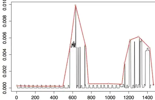

Update: Actually, I want to do model based clustering of time series data. But currently I want to fit the distribution to my raw data, as shown in Figure 1 on page no. 3 of this paper. For your quick reference, mentioned figure in said paper is enter image description here

  • Ok. But clearly there are two peaks in the original plot. Can't I fit Guassians around these two peaks. Mainly I am concerned how to fit a distribution to the original given time series data. – Haroon Lone Nov 18 '15 at 01:42
    There are about twenty peaks. There is a dominant alternate level. There is no Gaussian distribution here (not even the bell-shaped curve you get when integraring over Gaussian data). You need to understand this difference, or you will be on the wrong track. – Has QUIT--Anony-Mousse Nov 18 '15 at 07:10

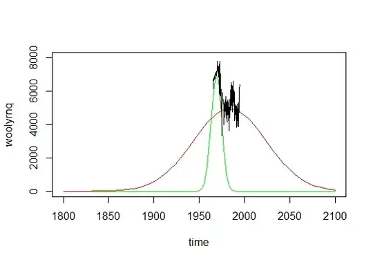

The plot above, if expanded a little bit, could be also a very good example of why using such method is not really the best way to go with time series, what would get obvious if you look at the plot below.
As you can see, if you made predictions from such mixture model, you'll conclude that there were literally no wool production in Australia before 1850 and there would be no such production in ninety years from now. Time series are not really Gaussian shaped, so such methods should be used with caution.
