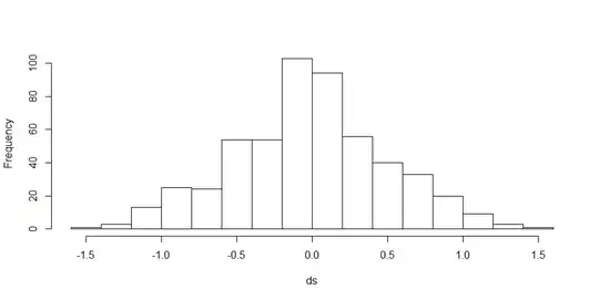

I wrote a simulation, to test this.
With a small effect size (difference of 0.1, population SD of 1 in both groups), a maximum sample size of 5000, and 1000 simulations it gets a significant result 99% of the time. In 93% of cases, the result is in the correct direction. Interestingly, the effect is massively overestimated - the average absolute difference is 0.3., as can be seen in the histogram below.
Histogram of effect sizes
d <- 0.1     #Population difference
n <- 5000    #Maximum number of subjects to run
set.seed(123456)
nSims <- 1000
ds <- rep(NA, nSims)    #Store the p-values
ps <- rep(NA, nSims)    #Store the differences
for(loop in 1:nSims){
  df <- data.frame(x=sample(c(0, 1), n, replace=TRUE)  , y=rnorm(n))
  df$y <- df$y + df$x * d
  stop <- FALSE
  count <- 20   #Going to count the number of rows through the data frame
  while(stop == FALSE){
    tRes <- t.test(df[1:count,]$y ~ df[1:count,]$x)   #Do t-test
    if(tRes  $p.value < 0.05) {
      ds[loop] <- tRes$estimate[2] - tRes$estimate[1]
      ps[loop] <- tRes$p.value
      stop <- TRUE
    count = count + 1
    if(count==n) stop <- TRUE
  #cat(loop)
  print(tRes)
  print(loop)
ps[!is.na(ps)]
ds[!is.na(ds)]

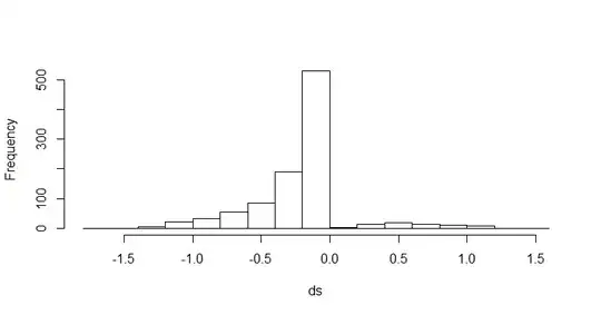

I reran it, with an effect size of 0. This took about 16 hours to run. Only slightly more than half of the simulations got a significant value, the histogram of effect sizes looked like this:
Histogram of effect sizes for d=0
And the mean absolute difference was 0.40.

  • +1 That's a nice simulation (my simulations under the null used replicate and ran faster, but what I did was also slightly different). However, I couldn't find what @gung had to say. Can you point me to where he said it? Did he delete a comment or something? – Glen_b Nov 17 '15 at 03:55
  • @Glen_b - yes, replicate would have been faster. Apologies, I wrote gung when I meant glen_b. – Jeremy Miles Nov 17 '15 at 09:45
