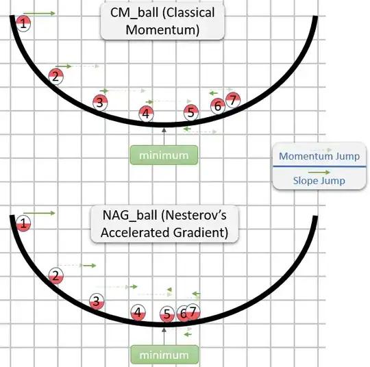

  • CM_ball didn't think it mattered, so he decided to always start with the Slope Jump.
    Thus, CM_ball's Double Jump is: $$v_{t}=\mu v_{t-1}-\epsilon\nabla f\left(\theta_{t-1}\right)$$
  • In contrast, NAG_ball thought about it for some time, and then decided to always start with the Momentum Jump.
    Therefore, NAG_ball's Double Jump is: $$v_{t}=\mu v_{t-1}-\epsilon\nabla f\left(\theta_{t-1}+\mu v_{t-1}\right)$$

Finally, yesterday I was fortunate enough to observe each of the balls jumping around in a 1-dimensional parameter space.
I think that looking at their changing positions in the parameter space wouldn't help much with gaining intuition, as this parameter space is a line.
So instead, for each ball I sketched a 2-dimensional graph in which the horizontal axis is $\theta$.
Then I drew $f(\theta)$ using a black brush, and also drew each ball in his $7$ first positions, along with numbers to show the chronological order of the positions.
Lastly, I drew green arrows to show the distance in parameter space (i.e. the horizontal distance in the graph) of each Momentum Jump and Slope Jump.
CM_ball vs NAG_ball example

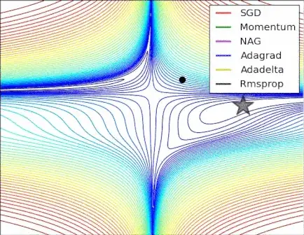

In this mesmerizing gif by Alec Radford, you can see NAG performing arguably better than CM ("Momentum" in the gif).
(The minimum is where the star is, and the curves are contour lines. For an explanation about contour lines and why they are perpendicular to the gradient, see videos 1 and 2 by the legendary 3Blue1Brown.)
NAG better than CM (Momentum)

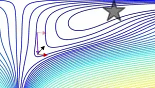

An analysis of a specific moment demonstrates NAG_ball's reasoning:
CM vs NAG in a specific moment
  • The (long) purple arrow is the momentum sub-step.
  • The transparent red arrow is the gradient sub-step if it starts before the momentum sub-step.
  • The black arrow is the gradient sub-step if it starts after the momentum sub-step.
  • CM would end up in the target of the dark red arrow.
  • NAG would end up in the target of the black arrow.
