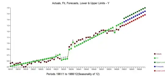

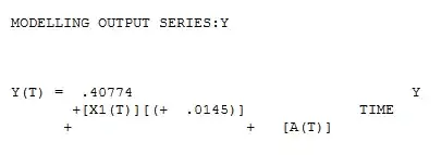

Since @Veneeth asked for a quantitative example , I attempt here to answer that. With apologies to Charles Dickens one could entitle this as " A tale of three approaches" I selected a real world example not a trivial textbook example which emphasizes the impact of presumption when it comes to model identification . Consider 1) The time based model (the only non-automatic run ) . Here is the actual fit and forecast enter image description here with equation enter image description here and residual plot enter image description here . Followed by 2) The ARIMA model . enter image description here enter image description here enter image description here Now consider a hybrid model incorporating both deterministic structure (input series) and ARIMA enter image description here enter image description here enter image description here . The variance of the errors from each of the three models reduced dramatically. The deterministic structure that was identified in the hybrid approach was a Level/Step Shift which reflects an intercept change. Visually one could make a case for a possible two-trended model using approach 1 yielding but no no avail enter image description hereenter image description here enter image description here

  • I attempted to modify my answer. If you can aid my explanation please do so . – IrishStat Oct 31 '15 at 18:19
