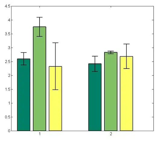

Standard deviation on bar graphs can be illustrated by including error bars in them.
The visualization(source) below is an example of such visualization:

    The principle is clearly along the right lines, but I'd suggest refinements to your graph. If bins are for touching intervals, then the bars should touch too and indicating bin boundaries alone is sufficient. Regardless of that, the cross-hatching is, in my view, just a distraction here. BTW, how would you denote error for a zero observed count? – Nick Cox Oct 19 '15 at 12:29
    At least this example has the error bars on both sides, the worst "dynamite plots" don't even have those, see here for one example. – Andy W Oct 19 '15 at 12:32
  • @NickCox I just lifted it up from the web. And yeah, the bins should touch for touching intervals(but here they aren't, so I think it's alright here). And yeah, the hatching is distracting. I need to plot one for getting my head around how to get a zero observed count on it. – Dawny33 Oct 19 '15 at 12:33
  • @AndyW After reading that article, I too hate dynamite plots now :D
    These are good enough then. So, are these dynamite plots with less opacity? (Maybe ;-) )
    – Dawny33 Oct 19 '15 at 12:35
  • This plot comes with a HUGE caveat that it is only meaningful if the zero mean has some special meaning! Because yellow bars all stretch down to zero and so emphasize it immensely. An (often preferred) alternative is to remove the bars altogether, leaving only points and whiskers. – amoeba Oct 19 '15 at 12:40
  • Me and Nick touched upon the points I think are the most noteworthy. Even ignoring the show the data point and just discussing showing the point estimates and the standard errors, the bars are generally superfluous, and they are even worse when they "cover up" half of the interval. Also bar conventions like anchoring to zero and having discrete bins can impede the viz. as well. Tukey has a great example of that in EDA. – Andy W Oct 19 '15 at 12:40
  • @amoeba So, you mean having only the error bars, instead of the error whiskers + bars setup? – Dawny33 Oct 19 '15 at 12:43
    No! I meant plotting error whiskers without plotting the bars. Bars are bad. – amoeba Oct 19 '15 at 12:43
  • @amoeba Yeah, I meant whiskers. That should look neat, but you need to have the dotted lines in the graph though. – Dawny33 Oct 19 '15 at 12:51
    I think bars can be fine for small counts, as in this example, and for some other measured quantities also with natural origin and reference level zero, so long as they don't occlude error bars. But bars can be silly and distracting (rather than bad) when it's not an issue whether values are or aren't zero. – Nick Cox Oct 19 '15 at 13:33
    Another possibility is a Cleveland dot plot (pdf), which is essentially the same as your dot & whisker version, except they go horizontally. Error bars are less common on dot plots, but are certainly acceptable. – gung - Reinstate Monica Oct 19 '15 at 15:31
  • @NickCox Replaced Image-1 with a better one. – Dawny33 Oct 19 '15 at 17:10
  • Thanks for removing the cross-hatching. Cutting out comments that are now irrelevant is (mostly) too difficult, – Nick Cox Oct 19 '15 at 17:25
    @NickCox I'd let them be there, as people can look at the edit history and learn why poor images shouldn't be used in answers :D – Dawny33 Oct 19 '15 at 17:27

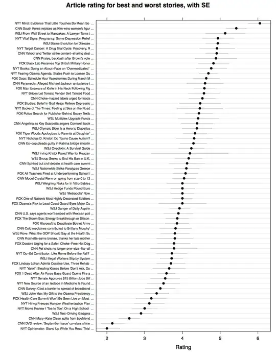

I'd suggest a dot plot:
Although there is still some room for improvement (perhaps dimming the edges of the big rectangle surrounding the data), almost all of the ink is being used to display information.
ToughTea
  • 91
    How does this answer the OP's question? How do you use dotplot with means and standard deviations? – kjetil b halvorsen Oct 19 '15 at 18:36
    This Stack Overflow page discusses how to generate dotplots from means and SDs. – EdM Oct 19 '15 at 18:46
    @kjetilbhavlorsen: The mean is the dot, and the standard deviation (or optionally, standard error of the mean) is shown using the length of the lines adjacent to the dot. –  Oct 19 '15 at 19:05
    (+1) The term "dot plot" is rather overloaded, my first thought was that you were going to suggest drawing dots for each data point (which of course the OP can't do, not having the raw data). I suspect this is what @kjetil wondered too. Does this variety of "dot plot" have a more specific name which distinguishes it from the "dot for each data point" type of plot? – Silverfish Oct 19 '15 at 20:27
