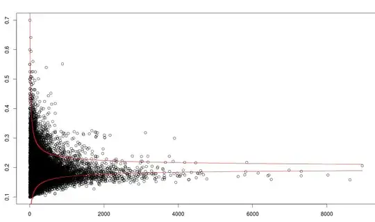

I have a distribution represented as a scatter plot (see image below). It is clear to me from looking at the plot that there is an L shaped curve that describes most of the data. I am interested in identifying the outliers from this distribution, the data points that are much higher on the y-axis relative to other points on the X axis. If I just set a hard cut off, such as take all values 2 SDs above the mean I will only get values with a mean > 0.6 on the Y-axis. But I am also interested in values with a lower mean, such as the data points further along the X axis that have means < 0.3 but which are clearly distinguishable as sitting above the general distribution in the scatter plot.
Context, if it helps: Each point is a gene and I am trying to detect genes with a mean score from a test that is noticeably above the genomic average, conditioning on gene size, which is on the X axis. As genes get larger, we expect the mean of this test to decrease. So I want to identify all genes that have high means, given their size.
Is there a statistically robust way to identify which datapoints are outliers relative to their position in the distribution? Another way to put it is I want to create a curve that describes the distribution of the majority of the data, and then identify all the points that are outliers above this curve.
I thought about dividing the distribution into bins based on X axis value, then for each bin identifying values that are 2 SDs above the mean for that bin. But then I have no good criteria for defining bin width, which would influence the total number of outliers I detect. I saw that a kernal density approach can be used to identify outliers in a scatter plot, though I am not familiar with this. Also this seemed to also detect outliers below the mean. I am only interested in outliers above the mean.
It would be great if this could be done in R, where I have been analysing the data.
Please let me know if I can clarify my question, I am probably not using the right terminology to describe my problem.
Thanks in advance.

I attempted to use a funnel plot, as this seems to be a good approach for my goal adapting code from an R tutorial http://www.r-bloggers.com/power-tools-for-aspiring-data-journalists-r/
number=mydata$total
p=mydata$mean
p.se <- sqrt((p*(1-p)) / (number))
df <- data.frame(p, number, p.se)
## common effect (fixed effect model)
p.fem <- weighted.mean(p, 1/p.se^2)
## lower and upper limits for 95% and 99.9% CI, based on FEM estimator
#TH: I'm going to alter the spacing of the samples used to generate the curves
number.seq <- seq(1000, max(number), 1000)
number.ll95 <- p.fem - 1.96 * sqrt((p.fem*(1-p.fem)) / (number.seq))
number.ul95 <- p.fem + 1.96 * sqrt((p.fem*(1-p.fem)) / (number.seq))
number.ll999 <- p.fem - 3.29 * sqrt((p.fem*(1-p.fem)) / (number.seq))
number.ul999 <- p.fem + 3.29 * sqrt((p.fem*(1-p.fem)) / (number.seq))
dfCI <- data.frame(number.ll95, number.ul95, number.ll999, number.ul999, number.seq, p.fem)
## draw plot
#TH: note that we need to tweak the limits of the y-axis
fp <- ggplot(aes(x = number, y = p), data = df) +
geom_point(shape = 1) +
geom_line(aes(x = number.seq, y = number.ll95, colour = "red"), data = dfCI) +
geom_line(aes(x = number.seq, y = number.ul95), data = dfCI) +
geom_line(aes(x = number.seq, y = number.ll999, linetype = factor(2)), data = dfCI) +geom_line(aes(x = number.seq, y = number.ul999, linetype = factor(2)), data = dfCI) +
geom_hline(aes(yintercept = p.fem), data = dfCI) +
xlab("number") + ylab("p") + theme_bw()
The result looks good, except that I the funnel plot lines are too short on both ends, not covering the X axis. Does anyone know the reason for this? I can't tell if it's a coding error or an analysis problem.
Version 2:
I also made a funnel plot using a different method with this code:
x <- Asianpig_data$total
prob <- Asianpig_data$mean
#generate 99% confidence intervals based on overall probability of pop_prob
alph <- 0.01
seq <- 1:(max(x)+5)
#via http://r.789695.n4.nabble.com/inverse-binomial-in-R-td4631935.html
invbinomial <- function(n, k, p) {
   uniroot(function(x) pbinom(k, n, x) - p, c(0, 1))$root
low <- mapply(invbinomial,n=seq,k=seq*pop_prob,p=1-alph/2)
high <- mapply(invbinomial,n=seq,k=seq*pop_prob,p=alph/2)
plot(x,prob)
lines(low,col='red')              #low and high funnel lines
lines(high,col='red')
It looks like this:
As far as I understand, the first funnel plot code calculates the standard error while the second code calculates the confidence intervals? I will investigate which is most appropriate for my data, any input is welcome.
Thanks in advance for your help.
