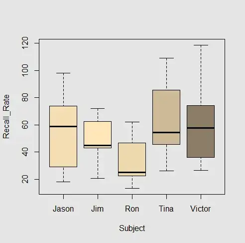

Why are all the Intercepts for the different subjects the same in the second example? The structure of the datasets and the lmer syntax appear very similar... and the boxplots don't seem to support the result:

  • can you show the estimated standard deviations of the random effects? – Cliff AB Sep 24 '15 at 21:32
  • Yes. I pasted the entire summary(), as well as the library to be called for the code to work seamlessly: library(gsheet). – Antoni Parellada Sep 24 '15 at 21:38
  • we can see from those results that the estimated standard deviation of the random effects is 0. Hence why the individual estimates are all identical. I'm sure your next question will be "okay, why?", but that's a longer answer than I have at the moment... – Cliff AB Sep 24 '15 at 21:44

Let's see the boxplot for this new, non-degenerated, dataset:
