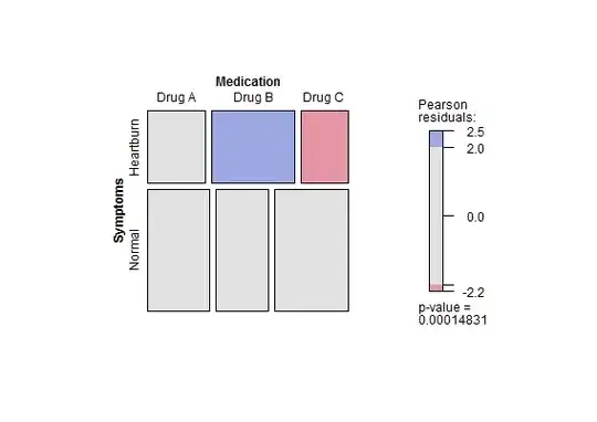

Interestingly, we can get this info all at once graphically simply with the following commands:
library(vcd)
mosaic(Antacid, shade=TRUE, legend=TRUE)
There you have it: when you look at the heartburn row, the square in pink, corresponding to Drug C is much smaller than Drug B (in blue), and the significance of the residuals (i.e. differences between expected and observed values for each entry, squared) are plotted to the right in terms of color hue: the darker the color (blue or pink) the larger the residuals. The residuals (distance from the expected value) can be exactly calculated to fully understand the plot by first summoning the table with marginal counts:

And these results explain the color coding in terms of the hue of pink and blue.
The column to the right also includes the exact same p-value we just got for the pairwise $\chi^2$ of Drug B versus Drug C with Bonferroni adjustment.
