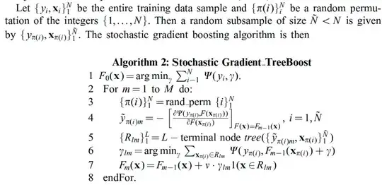

I tried to decipher the steps in the original Friedman 2002 paper. If I am not wrong, it appears that we actually both deal with the current residuals and the original training set. Especially, the algorithm is as follows:
Here is what I have understood, step by step. Please tell me if there is something amiss. See (*) below for some notation.
  • line 1: $F_{0}(x)$ is just an initial guess (and that's not what I'm interested in here)
  • line 4: we compute the current "pseudo-residuals" for a random subsample of the training set $(y_{\pi(i)},x_{\pi(i)})$ as the negative gradient of the loss function. By current, I mean that we want to add the $m^{th}$ base learner, and that the model so far is a sequence of $m-1$ base learners.
  • line 5: the $m^{th}$ base learner is a regression tree that partitions the space of the $x_{\pi(i)}$'s into $L$ disjoint regions $R_{lm}$ so that the within-region variance in terms of pseudo-residuals (computed at line 4) is minimized (this is how a tree works). The predictions $\bar{y}_{lm}$ made by the tree are the means of the current pseudo-residuals in each region. This is what I was referring to in my question by: how can we fit each new base model on the residuals of the current model...
  • line 6: within each region $R_{lm}$ found at line 5, we pick the expansion coefficient $\gamma_{lm}$ that minimizes the loss function (not its gradient, so we're not dealing with residuals here) evaluated on the random subsample of the target $y_{\pi(i)}$ and the corresponding predictions of the current model $F_{m-1}(x_{\pi(i)})$. This is what I was referring to in my question by: ...and at the same time on a random subsample of the original training set?
  • line 7: we add the (contribution of) the new base learner to the sequence as its expansion coefficients for each region multiplied by the learning rate. This final step is still a bit weird to me, as we are not directly adding the new base learner itself (unlike what the widespread belief about Boosting might suggest). But I guess this is equivalent, since the $\gamma_{lm}$'s inherently encode the information about the new base learner (they were estimated within each leaf of the tree).
*Some notation:
  • $(y_{i},x_{i})$ is the training set (target, predictor)
  • the goal of Boosting (like any other ML algo) is to approximate the function $F(x)$ that maps $x$ to $y$
  • The approximation of $F$ proposed by Boosting takes the form $F(x)=\sum_{m=0}^{M} \beta_{m}h(x,a_{m})$, where the $\beta$'s are expansion coefficients and the $a$'s are parameters of the base learners $h$'s (which are regression trees in Tree Boosting). So the $a$'s are the splits of the tree (optimizing the $a$'s=building the tree). $m$ is the number of base learners in the sequence. For trees, there is one $\beta_{m}$ per leaf, they are referred to as the $\gamma_{lm}$'s
  • $\Psi$ is any differentiable loss function. We want the $F$ that minimizes the expected value of $\Psi(y,F(x))$.
  • At each step, $F_{m}(x)=F_{m-1}(x)+\nu\beta_{m}h(x,a_{m})$
