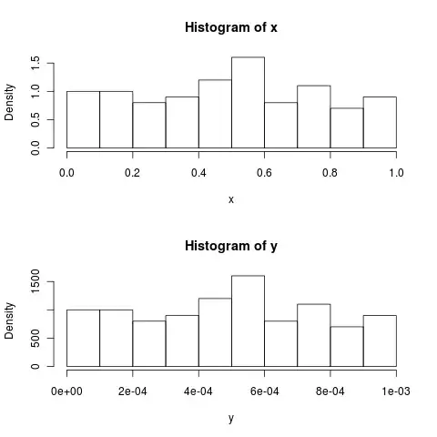

One explanation is that the standard deviation of your data is much less than one, and the histogram is giving something like the probability density.
For example, see how the density on the histogram changes when I divide a uniform random variable with range (0, 1) by 1000:
set.seed(4444)
x <- runif(100)
y <- x / 1000
par(mfrow=c(2,1))
hist(x, prob=TRUE)
hist(y, prob=TRUE)
If you want more intuitive looking density values, you could possibly change the units of the variable.

  • That looks to indeed be the answer. I'm hesitant to rescale it - may just have to do some adjustments to what I intended to graph. Thanks. – Fomite Oct 19 '11 at 09:06
