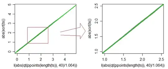

where $\tilde{x_i}$ is the median of sample $i$ and $q_i$ is the interquartile range of sample $i$ (which is analogous to a particular form of two-sample t-test for equal variance and equal $n$). I simulated 40,000 samples of size 30 and 30.
A Q-Q plot of absolute values of $t^*$ vs absolute values of quantiles of $c\cdot t_{40}$ (for $c=1.064$) is plotted below (grey), and the 45 degree line is drawn in green. The second plot shows detail in the region of typical significance levels (including, but not limited to values between 1% and 10%). The approximation is accurate to about 3 figures over most of that range.
[Similar plots are obtained for a variety of other degrees of freedom in the vicinity (with suitably chosen $c$) for each. Simulations at a variety of sample sizes suggest that t-distribution approximations work well across a wide range of $n$ for the equal-variance equal-sample-size case. I expect approximation via t-distributions will be adequate for the equal-variance unequal-sample-size case, but the simulations and analysis required would take a more substantial amount of time.]
