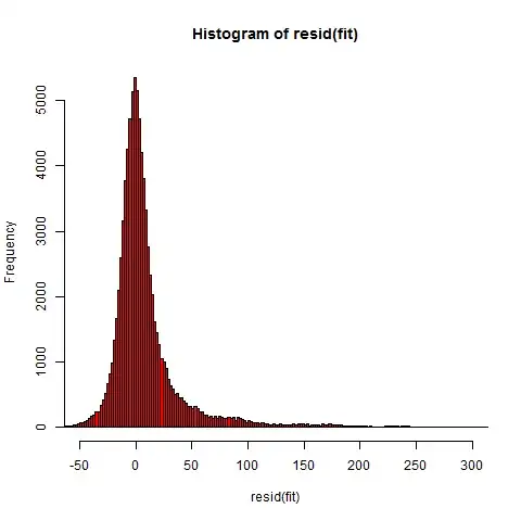

Residuals histogram (partial) below. Same image as above, but zoomed to the dense area.
