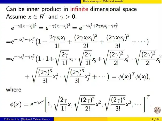

Transform predictors (input data) to a high-dimensional feature space. It is sufficient to just specify the kernel for this step and the data is never explicitly transformed to the feature space. This process is commonly known as the kernel trick.
Let me explain it. The kernel trick is the key here. Consider the case of a Radial Basis Function (RBF) Kernel here. It transforms the input to infinite dimensional space. The transformation of input $x$ to $\phi(x)$ can be represented as shown below (taken from http://www.csie.ntu.edu.tw/~cjlin/talks/kuleuven_svm.pdf)
The input space is finite dimensional but the transformed space is infinite dimensional. Transforming the input to an infinite dimensional space is something that happens as a result of the kernel trick. Here $x$ which is the input and $\phi$ is the transformed input. But $\phi$ is not computed as it is, instead the product $\phi(x_i)^T\phi(x)$ is computed which is just the exponential of the norm between $x_i$ and $x$.
There is a related question Feature map for the Gaussian kernel to which there is a nice answer https://stats.stackexchange.com/a/69767/86202.
The output or decision function is a function of the kernel matrix $K(x_i,x)=\phi(x_i)^T\phi(x)$ and not of the input $x$ or transformed input $\phi$ directly. enter image description here
