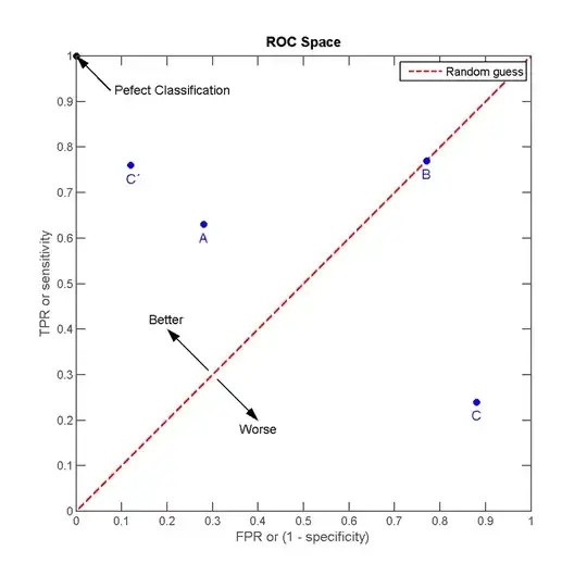

The following image definitely makes sense to me. enter image description here
Say you have a few trained binary classifiers A, B (B not much better than random guessing etc. ...) and a test set composed of n test samples to go with all those classifiers. Since Precision and Recall are computed for all n samples, those dots corresponding to classifiers make sense.
Now sometimes people talk about ROC curves and I understand that precision is expressed as a function of recall or simply plotted Precision(Recall).
I don't understand where does this variability come from, since you have a fixed number of test samples. Do you just pick some subsets of the test set and find precision and recall in order to plot them and hence many discrete values (or an interpolated line) ?

  • Are you asking why it's a curve instead of a single point? – Tchotchke Aug 13 '15 at 18:25
  • Yes. precisely, I mean for the whole dataset, say an SVM classifier gives one recall value and one precision. – valentin Aug 13 '15 at 18:31
