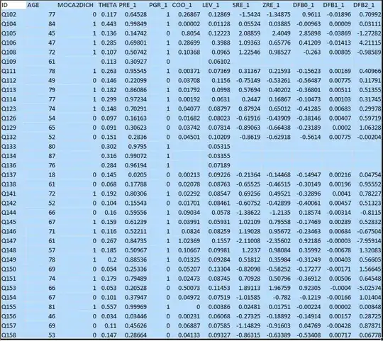

My data are includedenter image description here now
Emma
  • I think you may need to check you data to see whether they are reasonable. Since there are only 31 samples with two predictors, you may show your data here with some modifications. Then people can see what happened to your model. – Deep North Aug 07 '15 at 00:16
  • Thanks, I have added my data with assumptions testing as well. The columns to look at are predictors=Age and theta, dependent=MoCA dich – Emma Aug 07 '15 at 00:54
  • I have also checked each value for each participant and none are incorrect or unrealistic values – Emma Aug 07 '15 at 00:55

I used the first 15 observation to check your calculations. I think I did not find very very strange results. The followings are my R code.
age<-c(77,84,45,47,72,61,78,49,79,77,74,54,65,52,80)
theta<-c(0.117,0.443,0.136,0.285,0.107,0.113,0.263,0.146,0.182,0.299,0.148,0.097,0.091,0.151,0.302)
impaired<-c(0,1,1,1,1,NA,1,0,1,1,1,0,0,0,NA)
mydata<-data.frame(cbind(age,theta,impaired))
logistic <- glm(impaired ~ age+theta, data = mydata, family = "binomial")
summary(logistic)
I did not see big age coefficient but theta's coefficient might be too big.
Deep North
  • 4,746
  • Thank-you for your help. Could you explain your findings a bit more please. Are you indicating that the results I outlined for the binary logistic regression could be false/incorrect? – Emma Aug 07 '15 at 01:43
  • I think you may check your statistical program or procedures. – Deep North Aug 07 '15 at 01:46
  • I have re-run with the missing values removed and it makes no difference. I am using SPSS program so there are no options to mess up the input. I have also followed the procedure outlined in Andy Field's text book so I think that I have done all the test and input correctly. I think I will look into the suggestion below given by Ben and try out the solutions he thinks may work. – Emma Aug 07 '15 at 01:51
  • (+1) Note the standard error is not especially large compared to the point estimate of the coefficient. To be sure I copied your code & checked - there is no separation. (Including the further 16 observations could not introduce separation.) – Scortchi - Reinstate Monica Aug 07 '15 at 12:49
