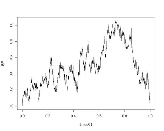

Here is an alternative construction based on a 3D Bessel process instead of a Brownian bridge. I use the facts explained in https://projecteuclid.org/download/pdf_1/euclid.ejp/1457125524
Overview- 1) Simulate a 3d Bessel process. This is like a BM conditioned to be positive. 2) Apply an appropriate time-space rescaling in order to obtain a Bessel 3 bridge (Equation (2) in the paper). 3) Use the fact (noted just after Theorem 1 in the paper) that a Bessel 3 bridge actually has the same distribution as a Brownian excursion.
A slight drawback is that you need to run the Bessel process for quite a while (T=100 below) on a relatively fine grid in order for the space/time scaling to kick in at the end.
## Another construction of Brownian excursion via Bessel processes
set.seed(27092017)
## The Bessel process must run for a long time in order to construct a bridge
T <- 100
n <- 100001
d<-3 # dimension for Bessel process
dW <- matrix(ncol = n, nrow = d, data=rnorm(d*n)/sqrt(n/T))
dW[,1] <- 0
W <- apply(dW, 1, cumsum)
BessD <- apply(W,1,function(x) {sqrt(sum(x^2))})
times <- seq(0, T, length.out=n)
# plot(times,BessD, type="l") # Bessel D process
times01 <- times[times < 1]
rescaletimes <- pmin(times01/(1-times01),T)
# plot(times01,rescaletimes,type="l") # compare rescaled times
# create new time index
rescaletimeindex <- sapply(rescaletimes,function(x){max(which(times<=x))} )
BE <- (1 - times01) * BessD[rescaletimeindex]
plot(times01,BE, type="l")
Here is the output: enter image description here
