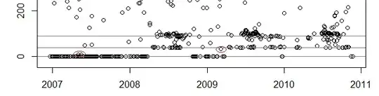

The data is given as a non-negative time series (data per hour). The data looks quite wild and contain many zeros. I expect these zeros to be the result of measuring quantities that are not zero but too small. It is ok to treat those zeros as zero.enter image description here

Looking at the plot though, I have some doubts that it's an adequate explanation for what we see:
Between the lower two grey lines, there are only three points, but a large number of points either exactly on the line (or very close to it). That big gap would be consistent with your thought, but those three points (circled in red) do not seem consistent with it -- if those points can register, why not others?
However, such a banding feature can sometimes be seen in Tweedie distributions as well; the tricky part would be whether it's even possible to get the right mix of parameters to match both the proportion of zeros and the banding at lower values.
(Beware interpreting those plots; the spikes at zero are not density but probability, and strictly speaking should not be represented on the same plot as the continuous part. You can draw a cdf but it's less clear what's going on.)
However, even more seriously perhaps, the Tweedie definitely cannot reproduce the clumping behaviour at the top end of the plot (for that matter neither can any of the other models I've mentioned).
