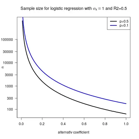

A graph showing minimum sample size as function of alternative coefficient $\beta_j^a$:
Minimum sample size as function of alternative coefficient
For completeness some related formulas from the same source:
If sample size $n$ is decided then power is $$ \gamma=1-\Phi\left(z_{1-\alpha/2}-|\beta_j^a| \sigma_x\sqrt{np(1-p)(1-\rho_j^2)}\right)$$ where $\Phi$ is the standard normal cumulative distribution function. The minimum detectable effect (on log-odds scale) is $$ \pm \beta_j^a = \frac{z_{1-\alpha/2}+z_\gamma}{\sigma_{x_j}\sqrt{np(1-p)(1-\rho_j^2)}} $$ The references given for this approximate formulas is A SIMPLE METHOD OF SAMPLE SIZE CALCULATION FOR LINEAR AND LOGISTIC REGRESSION which in turn for much of the theory refers to Sample Size for Logistic Regression With Small Response Probability which bases its result on approximations to the Fisher information matrix, so this is really based on normal approximations. It is known that normal approximations can be bad for logistic regression, so the results from this formulas should probably be checked by simulation.

Code for the plot:
ypos <- c(30, 100, 300, 1000, 3000, 10000, 30000, 100000)
plot(function(b) min_n(beta_a=b, sigma_x=1, p=0.5, R2=0.5),
     from=0.0, to=1.0, n=101, log="y", xlab="alternativ coefficient",
     ylab="n", yaxt="n", lwd=3)
axis(2, at=ypos, labels=sprintf("%i", ypos), las=1)
plot(function(b) min_n(beta_a=b, sigma_x=1, p=0.1, R2=0.5),
     from=0.0, to=1.0, n=101, log="y", add=TRUE, col="blue", lwd=3)
legend("topright", legend=c("p=0.5", "p=0.1"),
       col=c("black", "blue"), lwd=3)
title(expression(paste("Sample size for logistic regression ",
        "with ", sigma[x]==1, " and ", "R2=0.5")))
