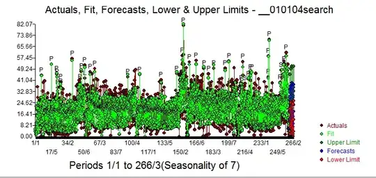

Parametric statistical tests often have unstated assumptions. For example the ADF test assumes no deterministic structure is present i.e. outliers/level shifts/seasonal pulses/time trends. The test also assumes invariant parameters over time. The test also assumes invariant error variance over time which is suspect given the plot of the data. Plots of data are often insufficient to identify assumption violations but in this case it is unusally informative. There is more than a hint of non-constant variance in the observed Y BUT the critical issue/assumption regards the constancy of the error variance from a reasonable model. I took your data and used AUTOBOX (my tool of choice), a commercial piece of software that I have helped develop to automatically analyze data. As surmised not only where there numerous pulses found but three points in time where the series changed level ( 465(+) , 904 (-) and 1792 (-) . Additionally a significant error variance reduction was detected at periods 926 and 1850 suggesting three regimes.
Following is a graph of the actual/fit and forecast enter image description here . The variance change points were enter image description here . The final model includes the 3 level shifts , a score of pulses and an AR(1) coefficient. Here are some model details ... enter image description here and enter image description here.
In summary the basic tools of ARIMA model identification make a lot of assumptions. Validating those assumptions and empirically identifying remedial action (pulses/level shifts/error variance breakpoints) culminates in what appears a satisfactory model. Unfortunately textbooks (even free on-line ones ) and very basic web tools are often inadequate to deal with the complexities you face with this data set. These are really not complexities but opportunities ! . The lessons from Ecclesiastes come to mind regarding when I was a child , simple tools were useful but as a man I need to use more powerful tools.....such is the advancement of science. Thanks for sharing this rather daunting time series with the group as there are lots of lessons to be learned here.
EDIT TO RESPOND TO COMMENT 1 and 2 :
The data is daily thus the seasonality is 7 as you have 7 readings per week. The transformation that is applied to Y is a weight derived from the significant change in variance that was detected at period 926 and 1850. In this case due to reducing error variance the whole idea here is that more recent values are more believable (less variability) and thus should have more weight. Non-constant error variance does not necessarily suggest the need for a power transform or a Garch transform as evidence of deterministic change points in error variance can be readily dealt with GLS (Generalized Least Squares) which essentially applies variance-stabilizing weights to the data. The actual weights used here for period 1-925 was .6 and for periods 926-1849 a .89 and for periods 1850-2314 a 1.0. These are computed from the two F values (.448.and .789 respectively ) . For example .89 is the square root of .789 .

  • Hi Dave, thanks a lot for the detailed explanation. I am currently trying to understand in more details about the points you mentioned in your comment. Could you please provide some details about how to does the x axis representation of the above plot relate to seasonality of 7? And which transformation is applied to the y axis? – Learner Jul 21 '15 at 08:50
  • See my EDIT which responds to your comment . – IrishStat Jul 21 '15 at 10:31
