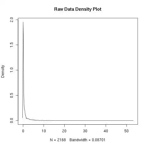

The data I am attempting to transform does not respond well to the traditional $\log (x + 1)$ transformation due to its distribution.
The data ranges from 0 to 52.99183.
The .RData file containing the data, the constant values, and the log.start function can be found at: Link to .RData
According to the code posted in this post: Choosing c such that log(x + c) would remove skew from the population , the $C$ value should be 0.001821598. I have plotted the data using R's density function and have attached the before and after photos below. Before Transformation After Transformation
Is it acceptable to use a value of $C$ which is smaller than 1 in order to transform the data? I would assume $C$ is any real number; however, I am not as well caught up on data transformations as I wish I was.

  1. Contrary to the post, the transformation seems to work quite well for your data. The approximately symmetric distribution looks well behaved for most purposes.
  2. The density estimate may smooth over discreteness or granularity of real or at least notable scientific or statistical importance. In particular, the spike around -5 may reflect a minor mode at around 0.01 in the data.

  • The data are measurements of biomass of insects from a stream. The following procedure will be multivariate ordination including PCA and NMDS. – branch.lizard Jul 08 '15 at 20:07

  • In this context of this data, the small spike could indicate a subset of individuals which have a similar biomass around 0.0067; however, I am not sure this is of interest to me. I expect the data to be quite varied due to its nature, but I would like to reduce this variation for downstream analysis. If I understand you correctly, you are saying the transformation I have suggested may be proper here? – branch.lizard Jul 08 '15 at 20:20
  • I am calling it ad hoc. The most positive translation of ad hoc is "fit for purpose" and it appears fit for your purpose. Simpler transformations which may be almost as good are square root and cube root. Reviewers and examiners can disagree in good faith in this territory, so other reactions might vary from "Fine" downwards. – Nick Cox Jul 08 '15 at 20:24
  • Ok, I understand what you are getting at. I will move forward with the analysis with the understanding that I very well may have to re-address this. Thank you for your time today. – branch.lizard Jul 08 '15 at 20:28
