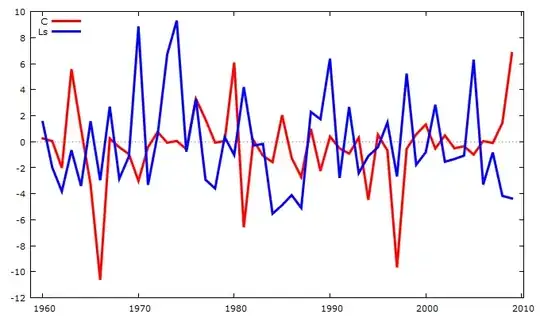

The standard example of a distribution with moments which some are infinite and some do not exist, is the Cauchy distribution, and it has already been mentioned. Assume now that a time series is a sequence of identically and independently distributed Cauchy random variables. More over, assume the existence of another time series, independent of the first which is comprised of i.i.d. Logistic random variables with scale parameter $2$ and location parameter $0$. Both are strictly stationary processes, the first has the "infinite/undefined moments" issue, while for the Logistic process, the moments exist. An indicative graph of a realization of the two is
where the red line is the Cauchy process, and the blue line is the Logistic process. One can see that the Cauchy does not exhibit a behavior that "betrays" the fact that it has infinite/undefined moments.
The lesson here is that the moments are a specific way to summarize/quantify fundamental properties of a distribution, like its location and its variability. These are more primitive concepts than the moments.
So for example if the moments do not exist, this does not mean that the concept of "location" is also undefined. A strictly stationary process, will have a constant location point. When this point cannot be described by a moment, it can be described for example by the use of the median of the distribution.
