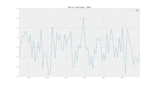

I have a series which moves about zero. Below is the series with an $S_{12\times 2}$ weighted moving average: enter image description here
The problem occurs when I divide the series by it's trend to de-trend the data. I get the following because the original dataset ~0 at February 2012: enter image description here
If I simply add 50 to the original series I get a decent result: enter image description here

Subtracting, i.e. raw - smoothed, will avoid the divide by zero (near zero) that is "blowing up" your de-trending.
