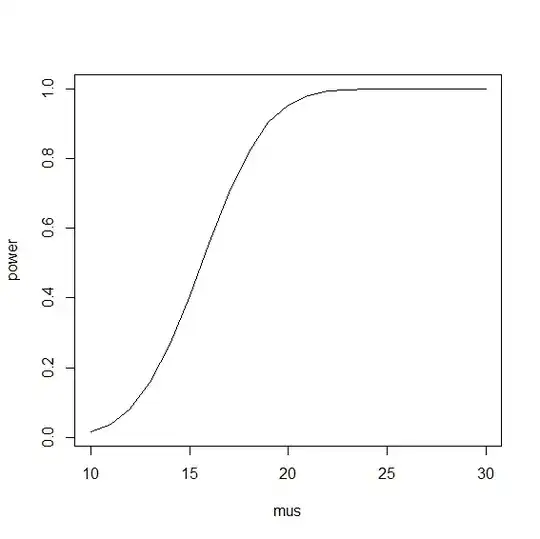

    To calcuate a specific power, you also need a specific effect size and type I error level, if you do not have a specific effect size, you can draw a power curve, think. – Deep North Jun 17 '15 at 01:15
I would say "Yes"power is alway associated with hypothesis testing it relates to sample size, type I error and both H1 and H0.
The followings are R code to show the power curve for OP's cases (one tailed at 0.05 level, by approximate a normal distribution.
mu<-30*0.35
sd<-sqrt(30*0.35*(1-0.35))
c<-qnorm(0.95,mu,sd)
mus<-seq(10,30,1)
power = 1-pnorm(c, mus, sd)
plot(mus, power, type="l")
